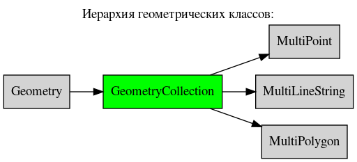

GeometryCollection - Коллекция геометрий
digraph geometry {
    label="Иерархия геометрических классов:";
    Geometry  [ href="Geometry.html#ref-label-geometry-class" ];
    GeometryCollection  [ href="GeometryCollection.html#ref-label-coll-class", fillcolor=green, style=filled  ];
    MultiPoint  [ href="MultiPoint.html#ref-label-mpoint-class" ];
    MultiLineString  [ href="MultiLineString.html#ref-label-mls-class" ];
    MultiPolygon  [ href="MultiPolygon.html#ref-label-mpoly-class" ];
    Geometry -> GeometryCollection;
    GeometryCollection -> MultiPoint;
    GeometryCollection -> MultiLineString;
    GeometryCollection -> MultiPolygon;
