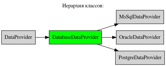

digraph geometry {
    rankdir=LR;
    label="Иерархия классов:";
      DataProvider  [ href="DataProvider.html#ref-label-dp-class"];
      MsSqlDataProvider  [ href="MsSqlDataProvider.html#ref-label-mssql-dp-class" ];
      OracleDataProvider  [ href="OracleDataProvider.html#ref-label-oracle-dp-class" ];
      PostgreDataProvider  [ href="PostgreDataProvider.html#ref-label-pg-dp-class" ];
      DatabaseDataProvider  [ href="DatabaseDataProvider.html#ref-label-dbms-dp-class", fillcolor=green, style=filled  ];
      DataProvider -> DatabaseDataProvider;
      DatabaseDataProvider -> PostgreDataProvider;
      DatabaseDataProvider -> OracleDataProvider;
      DatabaseDataProvider -> MsSqlDataProvider;
