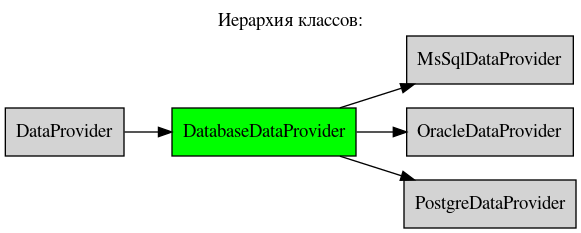

DatabaseDataProvider - Провайдер для баз данных
![digraph geometry {
rankdir=LR;
label="Иерархия классов:";
DataProvider [ href="DataProvider.html#ref-label-dp-class"];
MsSqlDataProvider [ href="MsSqlDataProvider.html#ref-label-mssql-dp-class" ];
OracleDataProvider [ href="OracleDataProvider.html#ref-label-oracle-dp-class" ];
PostgreDataProvider [ href="PostgreDataProvider.html#ref-label-pg-dp-class" ];
DatabaseDataProvider [ href="DatabaseDataProvider.html#ref-label-dbms-dp-class", fillcolor=green, style=filled ];
DataProvider -> DatabaseDataProvider;
DatabaseDataProvider -> PostgreDataProvider;
DatabaseDataProvider -> OracleDataProvider;
DatabaseDataProvider -> MsSqlDataProvider;
}](../../../_images/graphviz-4797d0752cf1ef4341ed31239a61e4aca63e3339.png)
