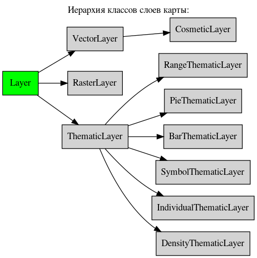

Layer - Слой
digraph geometry {
    label="Иерархия классов слоев карты:";
    Layer  [ href="Layer.html#ref-label-layer-class", fillcolor=green, style=filled ];
    VectorLayer  [ href="VectorLayer.html#ref-label-vectorlayer-class" ];
    CosmeticLayer  [ href="CosmeticLayer.html#ref-label-cosmeticlayer-class" ];
    RasterLayer  [ href="RasterLayer.html#ref-label-rasterlayer-class" ];
    ThematicLayer  [ href="../thematic/ThematicLayer.html#ref-label-thematiclayer-class" ];
    RangeThematicLayer  [ href="../thematic/RangeThematicLayer.html#ref-label-rangethematiclayer-class" ];
    PieThematicLayer  [ href="../thematic/PieThematicLayer.html#ref-label-piethematiclayer-class" ];
    BarThematicLayer  [ href="../thematic/BarThematicLayer.html#ref-label-barthematiclayer-class" ];
    SymbolThematicLayer  [ href="../thematic/SymbolThematicLayer.html#ref-label-symbolthematiclayer-class" ];
    IndividualThematicLayer  [ href="../thematic/IndividualThematicLayer.html#ref-label-individualthematiclayer-class" ];
    DensityThematicLayer  [ href="../thematic/DensityThematicLayer.html#ref-label-densitythematiclayer-class" ];
    Layer -> VectorLayer;
    Layer -> RasterLayer;
    Layer -> ThematicLayer;
    ThematicLayer -> RangeThematicLayer;
    VectorLayer -> CosmeticLayer;
    ThematicLayer -> PieThematicLayer;
    ThematicLayer -> BarThematicLayer;
    ThematicLayer -> SymbolThematicLayer;
    ThematicLayer -> IndividualThematicLayer;
    ThematicLayer -> DensityThematicLayer;
class axipy.Layer
Абстрактный базовый класс для слоя карты.
Для создания нового экземпляра для векторного или растрового источника данных необходимо использовать метод Layer.create(). Для тематических слоев — использовать соответствующие им конструкторы.
