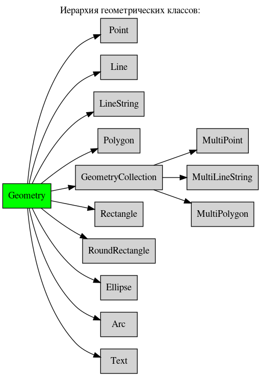

![digraph geometry {
label="Иерархия геометрических классов:";
Geometry [ href="Geometry.html#ref-label-geometry-class", fillcolor=green, style=filled ];
Point [ href="Point.html#ref-label-point-class" ];
Line [ href="Line.html#ref-label-line-class" ];
LineString [ href="LineString.html#ref-label-ls-class" ];
Polygon [ href="Polygon.html#ref-label-polygon-class" ];
GeometryCollection [ href="GeometryCollection.html#ref-label-coll-class" ];
MultiPoint [ href="MultiPoint.html#ref-label-mpoint-class" ];
MultiLineString [ href="MultiLineString.html#ref-label-mls-class" ];
MultiPolygon [ href="MultiPolygon.html#ref-label-mpoly-class" ];
Rectangle [ href="Rectangle.html#ref-label-rect-class" ];
RoundRectangle [ href="RoundRectangle.html#ref-label-rrect-class" ];
Ellipse [ href="Ellipse.html#ref-label-ellipse-class" ];
Arc [ href="Arc.html#ref-label-arc-class" ];
Text [ href="Text.html#ref-label-text-class" ];
Geometry -> Point;
Geometry -> Line;
Geometry -> LineString;
Geometry -> Polygon;
Geometry -> GeometryCollection;
GeometryCollection -> MultiPoint;
GeometryCollection -> MultiLineString;
GeometryCollection -> MultiPolygon;
Geometry -> Rectangle;
Geometry -> RoundRectangle;
Geometry -> Ellipse;
Geometry -> Arc;
Geometry -> Text;
}](../../../_images/graphviz-d761933c6b2bf4ae8741a0a7786954d6e551c0a8.png)
